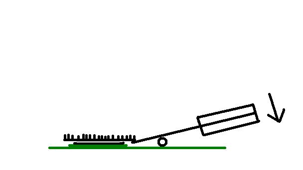

Hi! I did this procedure several times. There is part of this thread: http://www.3dfxzone.it/enboard/topic.asp?TOPIC_ID=1813  that takes care of the heatsink removal part. However I would suggest a more simple way. Take a pencil (or some plastic rod that has about 0.5cm diameter). Place it close to the processor, suspend a screwdriver on it, and just pop off the heatsink. Than you have to wash off the remaining glue. For that use some kind of solvent (eg. acetone). It is going to take a lot of time, because acetone will only soften the surface of the glue and you will have to shave it off layer by layer. The heatsink will need a bit of convincing to come off, but don't worry, the processor is not gonna come off. I will also supply an engineering plan of the procedure.;) Regards. Alpar

Condensation is far more dangerous than removing the heatsink at room temperature. This crystallization story is somebody's guess. My chemist opinion (Chemist by University degree) says that there is no so called crystallisation whatsoever at low temperature. The lower temperature might, and I repeat "MIGHT" increase the hardness of the glue, wich could help the glue to "break" in a very small amount. I think it is absolutely useless to cool it, because the heatsink can be removed easily without any cooling.(speaking from experience) BUT: try az you wish. The most important thing is not to suspend the screwdriver, putty knife or whatever on the pcb. You might cut some circuits by doing this. Regards. Alpar

I didn't use the freezer strategy nor your recomendation Mikulaish
I didn't want to place anything on the PCB.
I finnaly use a common knife with round edges (the type that doen't cute anything).
One of the GPU had a big gab between the heatsinnk and the chip, so it was fairly easy (The glue was badly applied)
I inserted the knife between and pulled carefully while holding the V5 firmly and flat.
The other GPU was another story because the heatsink was closer to the chip with no gap. So I use the knife as plateau on the bottom edge of the chip (near the PCB), then placed a small screwdriver between the chip and the knife and I was able to POP it off.
