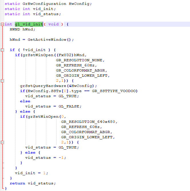

This is how it initializes
- grGlideInit() ... Sets up glide library. This has to be called first. Finds if you have a 3dfx card, allocate mem, inits variables...
- grSstSelect() ... This will make your card(s) current or active.
- grSstWinOpen() ... Thats my baby, since Im dealing with resolutions, it will prepare the framebuffer.
Whats sent to it:
GrContext_t grSstWinOpen(
 FxU32 hWin,
[b]  GrScreenResolution_t res,[/b]
 GrScreenRefresh_t ref,
 GrColorFormat_t cFormat,
 GrOriginLocation_t org_loc,
 int num_buffers,
 int num_aux_buffers
So here the resolution is set (sort of it goes through more checks). But broadly speaking, thats what Im looking for.
And since 3dfx gl icd calls glide then, that would be the one to catch.

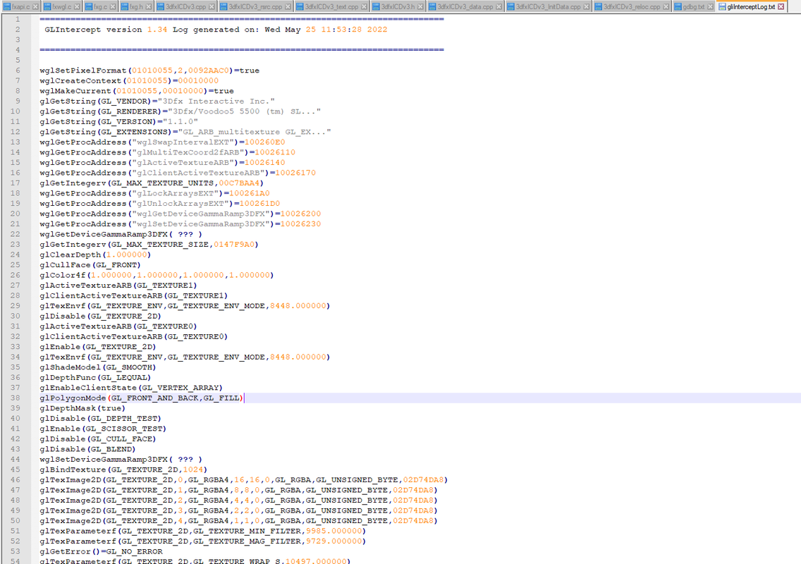

Lets catch the output of game calls to opengl icd, maybe something good comes up.
Useful tool GLIntercept: https://github.com/dtrebilco/glintercept
It logs all the calls from the game, to the opengl icd, this way you atleast see whats getting called. The tools can do a lot more, but for some other time, when Im more familiar.
Log looks something like this
Browsing through it, yea all good. No mention of the part where the icd makes the glide call, but for that to happen, you would have to log one step further. So atleast the conclusion that on the game side, when the calls are made, nothing fancy with any 3dfx trickery is going on.
Oke.. its something, still doesnt really help me.

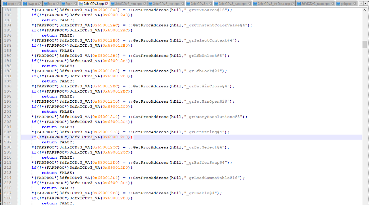

Lets open up the icd.dll
Well there are atleast method names, for further exploring.
