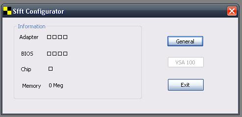

Hi, I tried to install SFFT Tools, but after installing it doesn't appears neither on Start Menu or Control Panel. Also it doesn't loads at Startup and if I start it manually from the .exe it doesn't show any info about my card.
I tried to use SetTile to see if with that I could use WarCraft III at higher resolutions but when clicking them nothing happens.

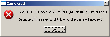

I have some serious problems with Alpha 58, I cannot start a single 3D application !
Battle for Middle Earth shows this error :

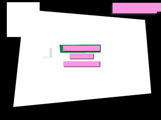

At least GTA:Vice City starts, but the main menu looks like this :
27.65 KB
Even Glide does not work.
What is very strange is that I cannot even play videos, I tried mpegs and avis, but there is no picture, just sound.
With Alpha 57 and before there were no problems at all.
Test system is as usual Pentium4-EE-3400, Asus P4C800E-dlx, Voodoo4 AGP and WinXP SP1.
13.95 KB
I can't use C:\Program Files\Sfft\SetupSFFTTools\Configurator.exe
I must use  C:\Program Files\Sfft\SetupSFFTTools\IconMgr.exe
then clik icon from systray to do config
