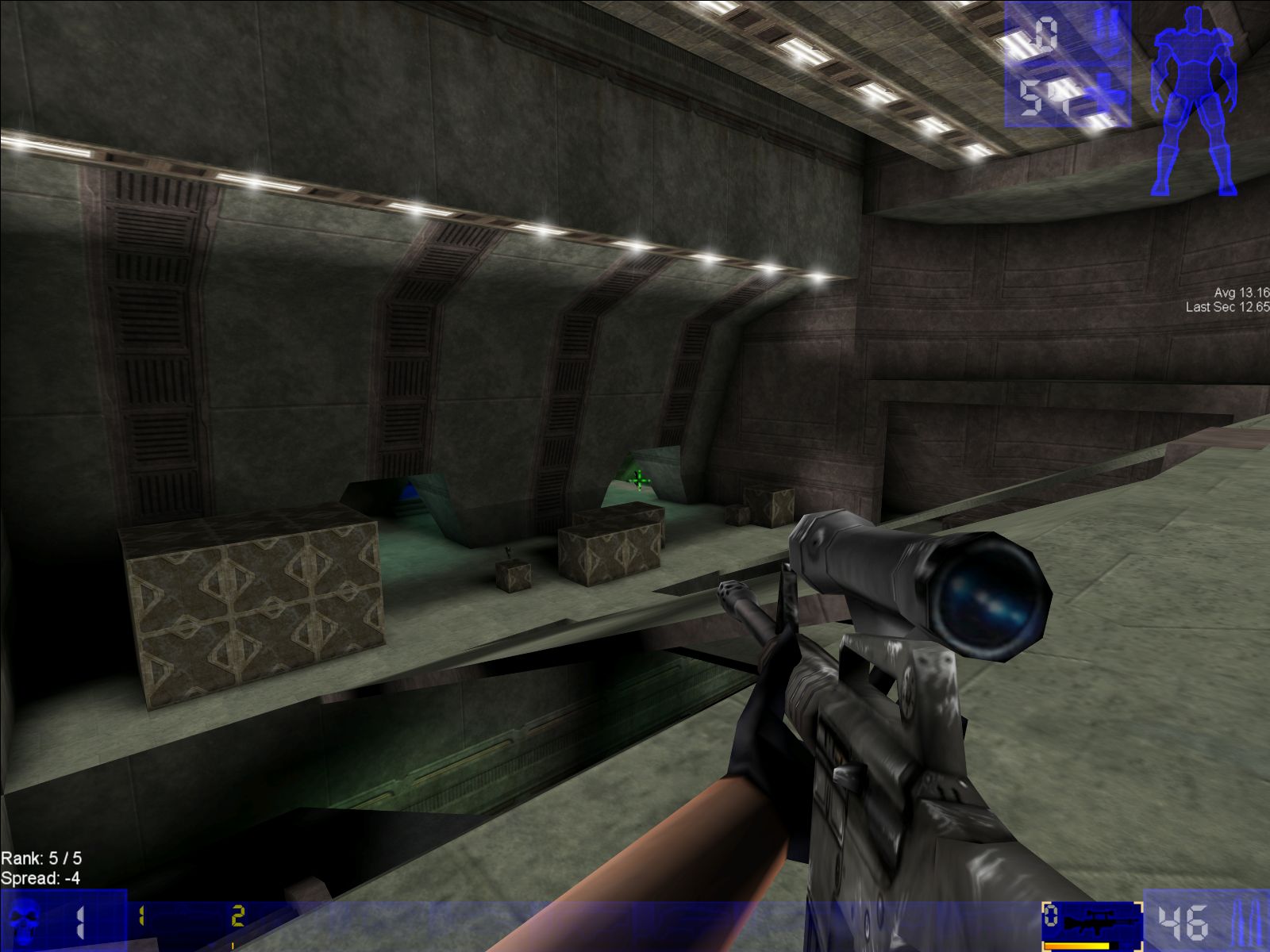

I was deleting some files from my computer when i remembered i have a nice screenshot from unreal tournament in 1600x1200 with 8x fsaa enabled :) To me its old news but im not sure it is to you. When i told Amigamerlin about it he seemed pretty surprised by this so i figured some of you would like to see it too. Is a glide render so its only 16 bit. And becuase i made it a jpeg the quality has decreased enormously, im sorry for that but the original tga was around 7 megabyte. Well ill just put the picture here ill see what comes out.

So I suppose that 1600 x 1200 x 32 with FSAA x4 is also possible on the Voodoo5 5000  as the Voodoo5 5500 at 1600 x1200 x32 with FSAA x2 on the Voodoo4-2 4200, Voodoo4 4500 and Voodoo4-2 4800 cards, Theoreticly then [?]
im not sure i i guess its possible. It depend on the amount of memory on the card. I only know that the 6000 has a theoretical limit of 1600x1200 with 8x aa. Im not sure if it was 16 or 32 bit. Well 16 bit (glide) seems to work so the 5500 should be able to manage 1600x1200 with 4 x aa. I'de say lets try it out :)
InSomNiaN
At 1600x1200 the voodoo5  only uses one VSA chip, thus the poor performance, so only 2x would be possible...[xx(]
Hmm interesting i didnt know that. Well maybe i can find some time to change the 6000 for the 5500 once to check it out.

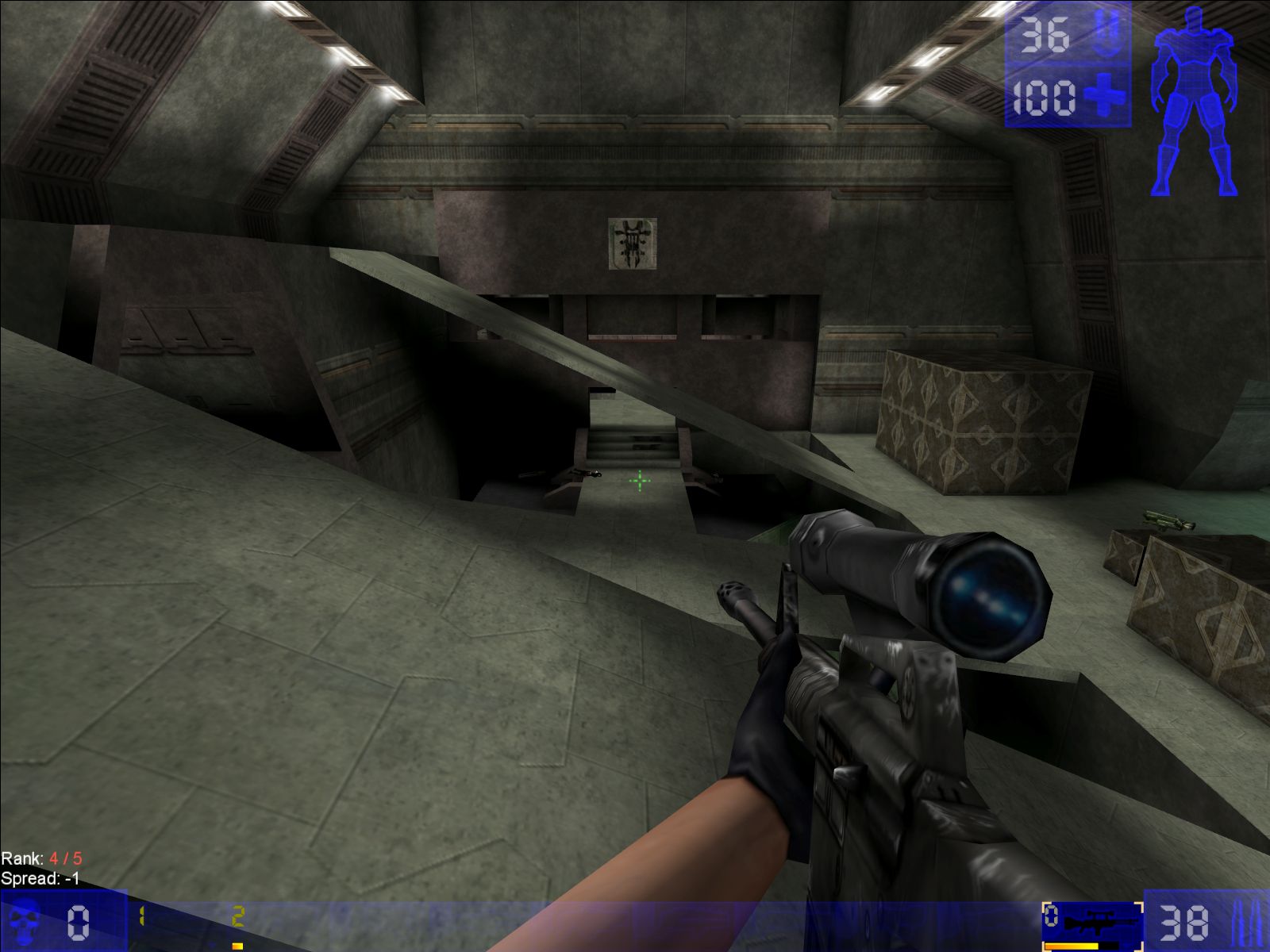

QuoteSo I suppose that 1600 x 1200 x 32 with FSAA x4 is also possible on the Voodoo5 5000  as the Voodoo5 5500 at 1600 x1200 x32 with FSAA x2 on the Voodoo4-2 4200, Voodoo4 4500 and Voodoo4-2 4800 cards, Theoreticly then
QuoteAt 1600x1200 the voodoo5 only uses one VSA chip, thus the poor performance, so only 2x would be possible...
Seems your right again obi-wan(just like 2048x1536@Q3A) UT does 1600x1200x16 with 4xAA on 5500. Using Amigamerlin 3.1R1 now. Very old topic now but still interesting that it exeeds the expected 2xAA from Insomnian.  :)

Those are some sweet screenies! Too bad the FPS wasn't higher. :(
