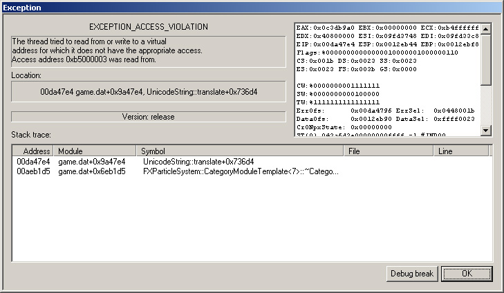

I tried Battle for Middle Earth 1 with SFFT Alpha 38 ( WinXP ) and noticed that the letters in the menu and on the buttons are messed up ( not readable ). This was working in Alpha 36 I think.
When entering a game ( intro works ) I got this error box :
112.84 KB

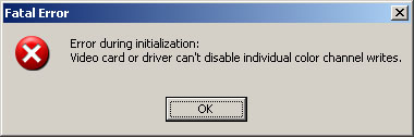

When I tried to run Call of Duty 2 I got this :
24.15 KB
