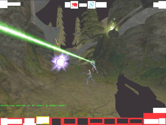

This one is a Unreal Tournament 2004 screenshot by 3dfx Voodoo2 SLI cards (2x12Mb):
Besides, you can run this game w/o OS registry mod and OpenGL copy into Windows folder.
Simply overwrite ut2004.ini with this UT2004.zip and copy openGL32.dll from MesaFX package to UT2004 System folder.
That's all,
good luck 3dfx users :)

The following issues are most annoying with MesaFX in UT2004:
- The Squares instead of test is due to the missing render to texture capability I guess. I also can see such white squares in other programs. f.e. try the 'Variform' Demo or similar stuff.
- The many Texture Layers make the world look very rastered.
- The Screen Size is not adjusted correctly, only 640x480 are visible from the lower left corner of the whole screen.
I think the first issue may be possible to be emulated by mesafx, the last issue seems to be some bug?
A visible 1024x768 resolution would be fine on a V2 SLI 8)
