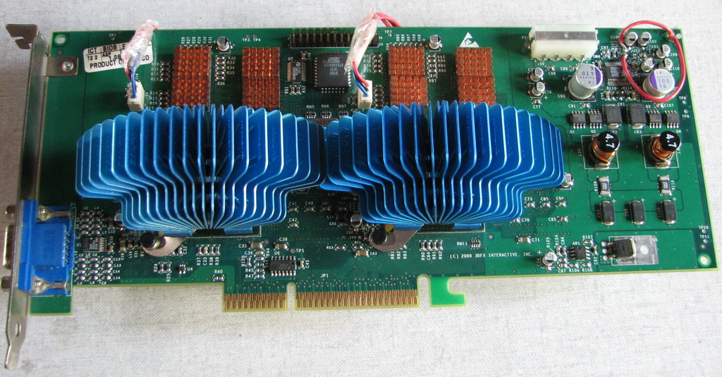

The improved cooling system is just done on my Voodoo5. Lot of work, but it cools significantly better. The overclocking ability also improved, now it is stable on 199MHz.
I have also realized the back side of the VSA100 chips heats more than the front side. I still feel them for too hot, I might have to add fans on to it before overvolting.

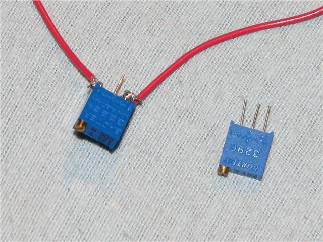

QuoteOriginally posted by Atom_Anti via e-mail
Hello Goriath,
Now I have all the equipments, that is necessary to do the overvolting my Voodoo5.
I need some further guide, because I am not sure how to solder the wire into the trimmer. The trimmer has 3 pins, but probably I should use only two of them. Which is that two? See my picture, than you can understand better my question.
Atom_Anti
Here the picture from you:
64.47 KB
Yes, only two pins are needed; these are the first and the second one(or the second and the third one, is the same). In a few words, you must solder the central pin and one of two external pins.

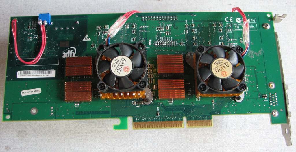

Ok, I am successfully overvolted my second Voodoo5. The first one is dead unfortunately, because I did not have any soldering experience and I screwd it up. It is very sad, that was an very good overclockable V5.
The overvolted Voodoo5 works wonderfully, I can regulate the VSA100s voltage in any range. It can work even with as low voltage as 2,4V and I have already increased it up to 3,2V so far. Might I will increase it further on a colder day.
Here how is look an overvolted Voodoo5:
front side:
277.37 KB
back side:
250.36 KB

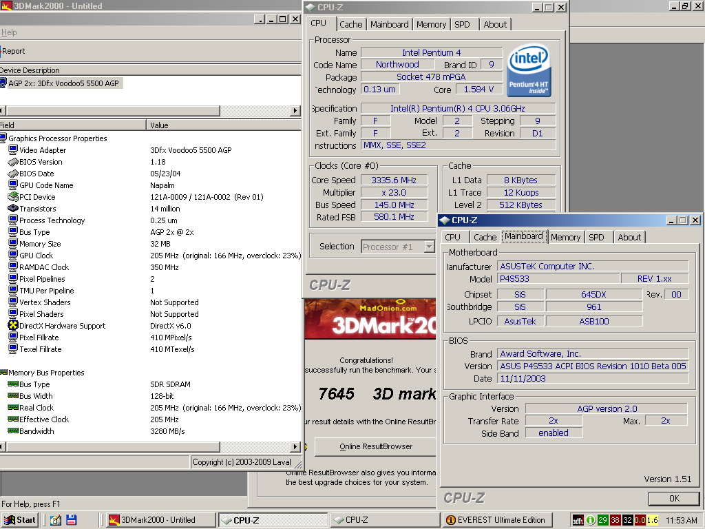

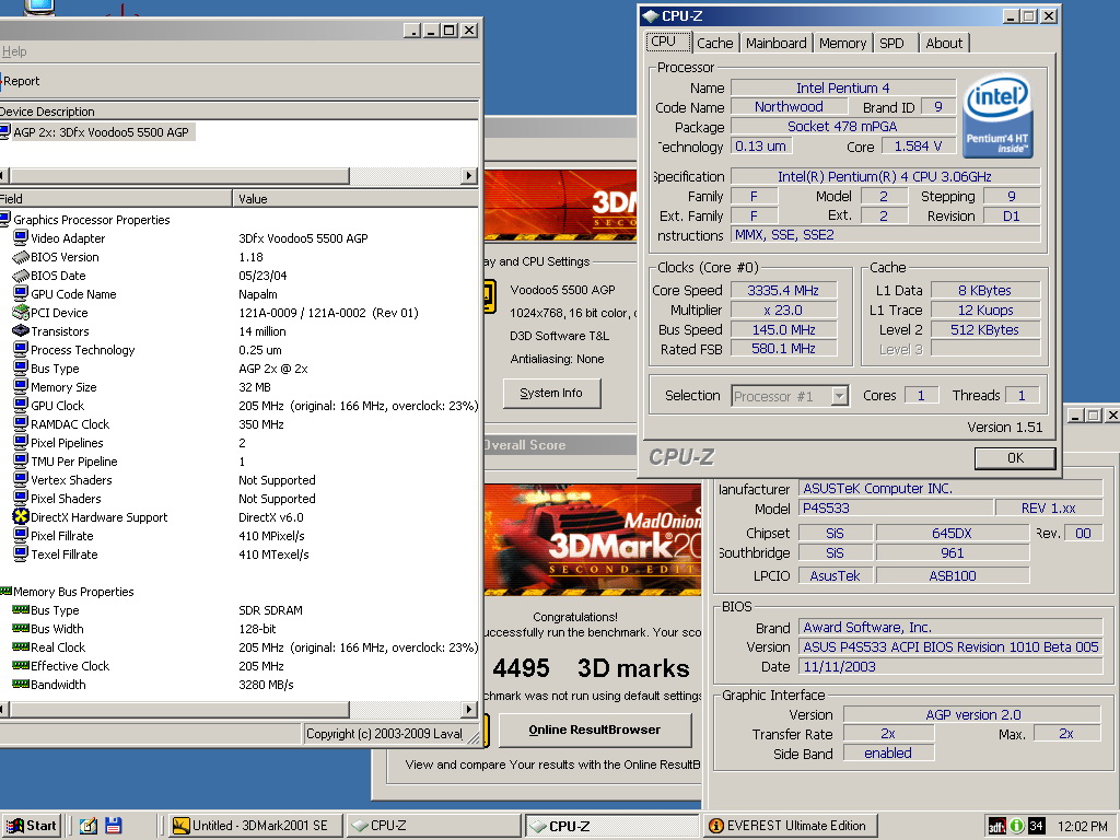

Here are the results:
3,2V-->205MHz
3,1V-->202MHz
3,0V-->200MHz
2,9V-->198MHz
2,8V-->196MHz
2,7V-->192MHz
2,6V-->189MHz
2,5V-->187MHz
2,4V-->180MHz
These are stable MHz -es, tested with 3D Marks.
Few scores with pictures:
3DMark 2000:
250.7 KB
3DMark 2001SE:
270.29 KB
